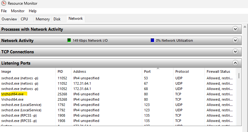

    To clarify for others:
    1. Check if port 80 is "occupied. For me "System" was occupied port 80.
    2. Open MMC (Computer Management)
    3. Inside "Services" list find World Wide Web Publishing Service.
    4. Rightclick and Stop.
    5. Restart appstudio and robotstudio.

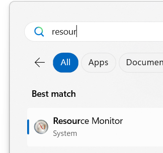

  • The reason why you cannot connect to virtual controller via AppStudio is possibly that the 80 port is occupied. you can check if it is occupied via "Resource Monitor" and then try it again after disabling the service that occupies 80 port and restart RSThe “Vrchost64.exe” is the virtual controller.
  • Thanks for tip, in my computer port 80 is occupied by SYSTEM and I don't want to shut down SYSTEM. Is it possible to change port instead inside AppStudio?

    Check if you have the World Wide Web Publishing Service running.
    It will show as SYSTEM in resource monitor test above.
    If it is running (and don't need it), disable it or set it to manual in the services MMC
    You should then be able to connect.
