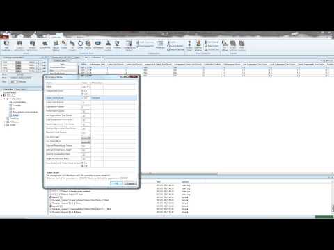

I have / or am creating a robot and positioner system ( for example, IRBP A). But the rotation of the second axis (the flange table) is limited to 1416 degrees. Can I change the limit values for the second axis, such as making 10,000 degrees. And how do I do that?
I tried, as in the video, only the values for the first axis changed. I set the value to 100, and in the jogging window the values became 5729 - this is for the first axis. No changes for the second axis.
Help me, pleasePost edited by selivanov on0 -
That is, for the axis in the in the Motion topic, type Arm tab, the value changes. and Plate doesn't change...
The values specified for axis limits are set in units of radians.Lee Justice0
Yes, taking into account it all turned out in one system, but in the drcoc is still unchanged.0
