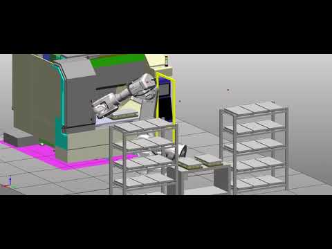

I am having some issues with axis configurations. If I use anyone of the available options in the configuration tab of each point it gets an error when simulating. If I go into Rapid Robtarget and edit them to a different value they work. One of the moves in question at the 2-3 second mark in the video linked below. The point is driven from a generic RobTarget that is populated with the correct target info based on the variable for the pallet number. code below. Any ideas? TIA
https://youtu.be/BM8dVJjZKTQ

Maybe you didn't use the hook to show all available configurations? It is called "Include Turns".BTW: your robot can work more efficient with zones.0
you could also use confL\off for the part of the path that is causing issues (turning back on (confL\on) normally when you are away from obstructions and probably with a MoveJ so the axis can reset)
