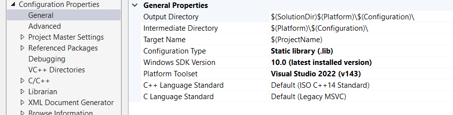

I'm trying to set up Externally Guided Motion (EGM) for a CRB 15000 GoFa Arm and an Omnicore Controller and I want to use C++ in VS 2022 for that. I find the ABB instructions and resources quite insufficient, and unfortunately most tutorials on installing Google Protobuf are at least two years old and a lot seems to have changed in the installation process since then. That's why it took me quite some time and Trial-and-Error to install Protobuf.
Now I want to run the egm-sensor.cpp example as a Console Application and managed to remove most compiler errors (it was definitely not plug+play), but:
- I can only Build the project when the result is a .lib file, which means I set the Configuration Type to Static library (.lib) (see image)
- For my understanding, I need some kind of executable file (presumably .exe) which is then executed together with the other program in RobotStudio, but when I use the Configuration Type "Application (.exe)" Visual Studio gives me 31 errors for "unresolved externals" from egm.pb.obj saying things like

Here are the other Project Properties, which might have an impact on the problem, but changing them up didn't create a working solution for me...
Solution Configuration: Release (x64)
- Precompiled Header: Not Using Precompiled Headers
- Runtime Library: Multi-Threaded (/MT) (as this seems necessary for Release)
- All the additional libraries are linked and can be accessed (which was a previous problem I had)
- Do I need to Build the VS project in Release Mode? (I thought so because otherwise I'd have to use libprotobufd.lib instead of libprotobuf.lib in the egm-sensor.cpp example.)
- What type of output do I want/ expect from my Build in order to run EGM? .exe or .lib or something else?
- Is there an error in my VS Project Properties that prevents my Build from working?
- Did I forget something fundamental that my I wasn't aware of?
