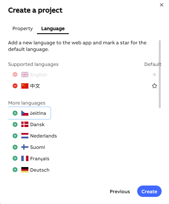

Hello, I think you want to create a multilingual project and preview it. Here is a very simple tutorial.
1. Create the project and configure its multilingual settings.

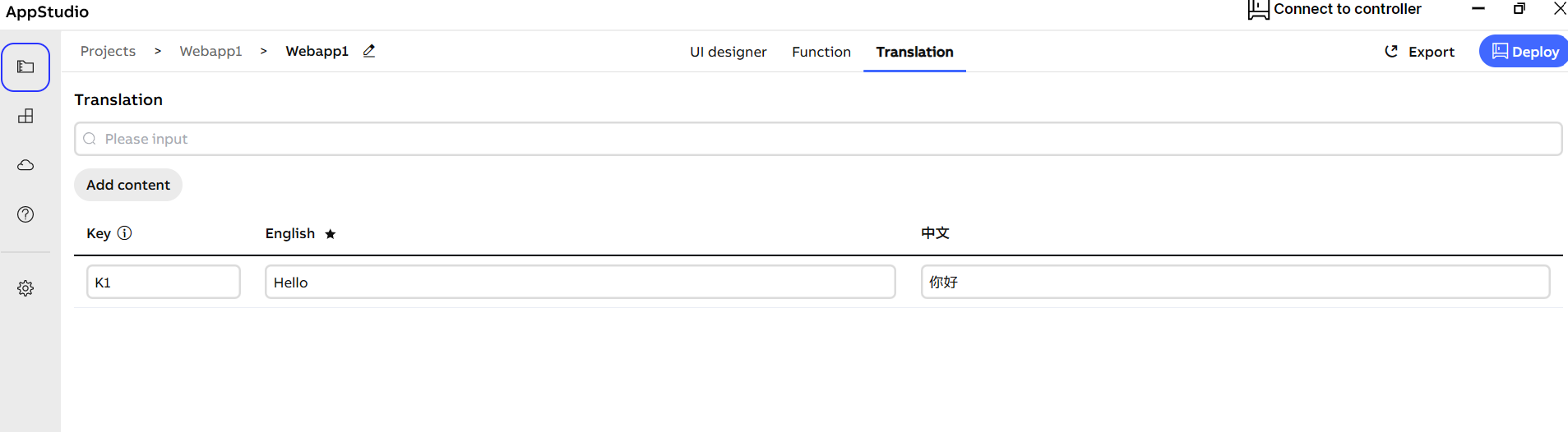

2. Add the corresponding multilingual entries in the translation Tab.

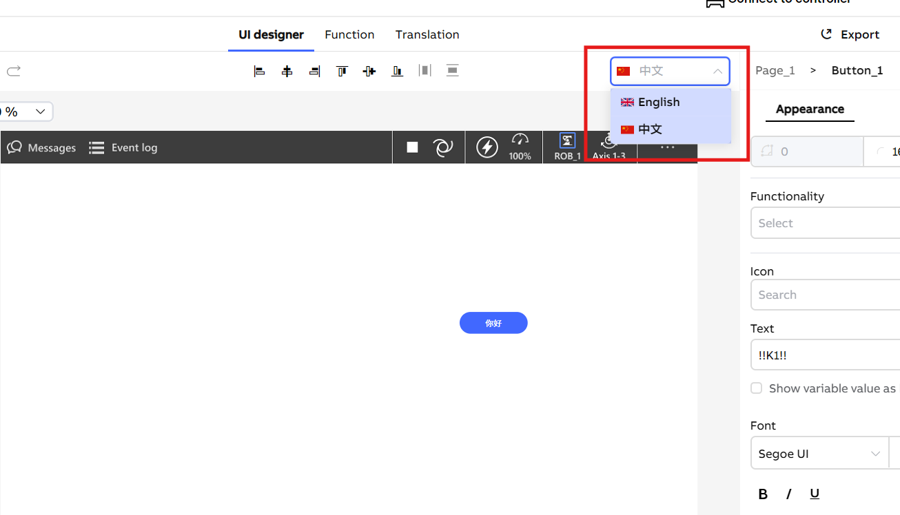

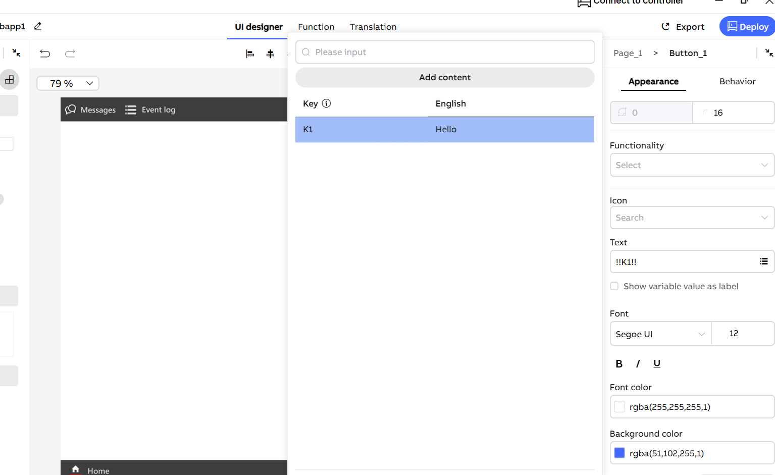

3. Bind the multilingual content to the text labels of the components and support previewing the multilingual effects.

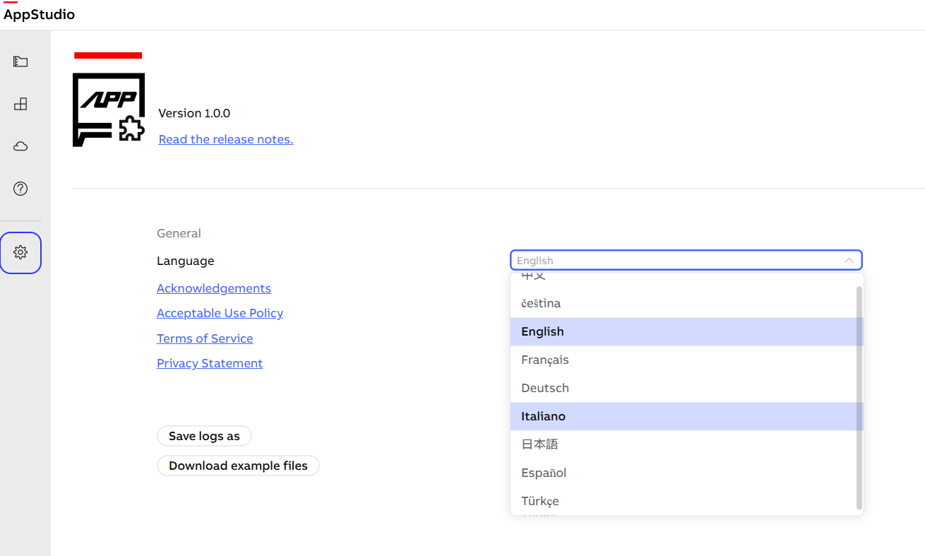

We also support switching the AppStudio software language, you can change your language setting refer to follow image.
