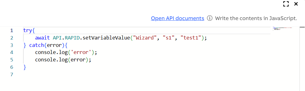

Hello,
We simplified the scenario into a webapp with one select component with onchange event as below:
We made a simple test as the attached video:
- Turn to manual mode
- Clear all event logs
- Open the webapp and trigger a onchange event of the Select component
- The variable value is changed correctly, no event logs mention operation mode has been changed into Auto, and apparently the controller is still in manual mode.
Please let us know if anything different from your scenario. That would be helpful if your appstudio project and the RobotWare version can be shared for further analysis.

thanks for the response. I reproduced your test with a simple webapp and the controller still changes into automatic mode.
After clearing all event logs and changing the selected entry in the select component in manual mode the following is shown in the event log (in chronological order):
10010 Motors OFF state
10012 Safety guard stop state
10016 Automatic mode requested
10017 Automatic mode confirmed
Here are infos about the system:
RobotWare 7.14.3
RobotOS 12.0.2
RobotControl 7.14.3
Robots 1.14.0
FlexPendantSoftwareUpdate 1.15.3
OmniCore-App-SDK-AppMaker 1.4.0
