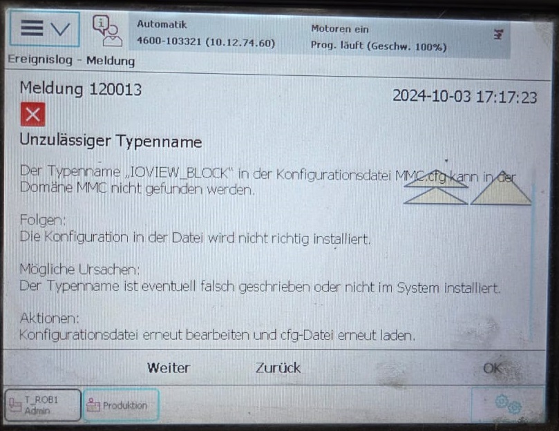

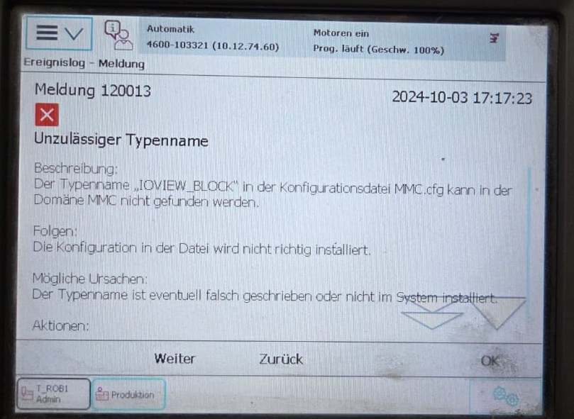

When attempting to teach my robot in manual mode via the IRC5 control panel, I receive the following error message:
Message 120013
Invalid type name
Description: The type name "IOVIEW_BLOCK" in the configuration file MMC.CFG cannot be found in the MMC domain.
Consequences:
The configuration in the file is not installed correctly.
Possible causes:
The type name may be misspelled or not installed in the system.
Actions:
Edit the configuration file and reload the CFG file.
This error has been occurring since I implemented a RAPID program that automatically creates a backup each time the robot is moved to its home position, overwriting the previous backup.
I have checked both older backups and the currently deployed program to verify whether the term "IOVIEW_BLOCK" was ever used — it was not present at any point. However, the system is now unexpectedly requiring the existence of this type, even though it was never previously needed or part of the configuration.
Question:
How is it possible that the system is now referencing a type name that previously did not exist, was never used, and was not part of any configuration?

  • Hallo, ich habe dazu etwas in der Dokumentation gefunden. IOVIEW_BLOCK ist ein Parameter, der ggf. verhindert, das im "Motoren aus"-Zustand E/A-Signale über TP oder RSO verändert werden können.
    In einer alten MMC sieht das bei mir so aus:
    IOVIEW_BLOCK
     -name "IOViewBlockIfMotorsOff"
    Benutzt habe ich das noch nie. Der Eintrag oben scheint auch ohne Funktion zu sein, da ein lt. Doku notwendiges "enabled" fehlt.
    Einfach den Eintrag mal der MMC hinzufügen und sehen was passiert.
    matti
  • again in English:
    I've found something in the documentation. IOVIEW_BLOCK is a parameter, which might restricts change of I/O signals from FP or RSO to status MOTORS_ON.
    In an old MMC.cfg it looks like:
    IOVIEW_BLOCK
    I never used this intentionally. The entry above seems to be nonfunctional, because an "enabled" is missing.
    Add this entry to your MMC and look what happens.

    Thank you very much for your help.
    The issue has been resolved – although I solved it by deleting the entire log.
    As you can see from the error message, it was dated 2024, which clearly couldn't be correct.
    So I figured I'd just delete the whole log.
    After that, the message disappeared and hasn’t shown up again since.
