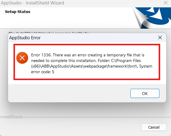

When you’re trying to install a new version of AppStudio, you may run into an issue where AppStudio cannot be uninstalled 😵💫
You’ll see an error message similar to this:
So how can we fix it?
From the error message, we can tell that some font resources used by AppStudio are currently being locked by other processes. To resolve this, we need to identify and stop those processes.

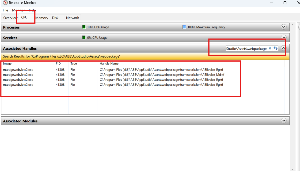

Method 3: Use Windows tools to find the locking process
If the issue persists, you can use a built-in Windows tool to identify which process is holding the files.
Press Win + R, type
resmon, and press Enter to open Resource Monitor. -
Go to the CPU tab.
In the Associated Handles search box, enter AppStudio’s installation path, for example:
C:\Program Files (x86)\ABB\AppStudio\Assets\webpackage -
Wait a moment to see which process is using the files.
Select and close the related processes.
