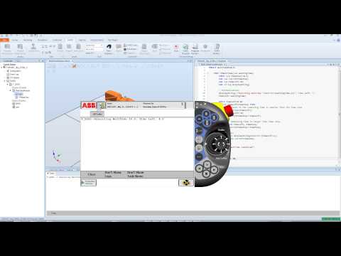

    I have created a procedure that prints out the remaining waiting time on the FlexPendant. Perhaps you can use it as a starting point.
    http://youtu.be/5Giis7fLG_c
    Here is the source code.
