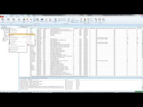

I amstudent and I have to do a little project with Robotstudio. I try to connect an
object with the tool (I created an aspirator) of the robot. You can take a
simple pick and place program as an example. So with the event manager I am
able to realize this function (signal is 1 = connect object; signal is 0 = free object)
But how can
I create an own signal and how can I implement this in rapid?
I know the
line SetDO “signalname”, 1; but the
name of the signal is always underlined in red, and the program does not work.
I make a fast progress in learning this program but this, I think easy problem, I
can not solve.
So I would
be grateful if you could help me with this.
I have create a movie that illustrates how to configure the I/O signals in the controller.
http://youtu.be/JSdcVxgR6hgHenrik Berlin
