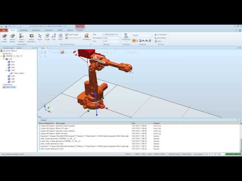

Attaching wire feeder to robot?
Yes it can be done:
- Expand the robot you should attach to in the Layout browser.
- Drag the object that should be attached to the link it should be attached to. Do not update the position if the part already is placed correctly in the space.
Regards,AndersBest regards,
Anders Spaak
ABB Robotics0 -
Thanks a lot!
It was too simple to figure it out my self.
-Aku
Hi Tunski,You need to attach wirefeeder to appropriate iink. You can find a simple example below.BR.Erdem Karaçeper0
Hi
i usually place the wire feeder in the right position using the holes on the robot as references and then drag and drop the library direct on the Link3 of the robot mechanism.
paola
