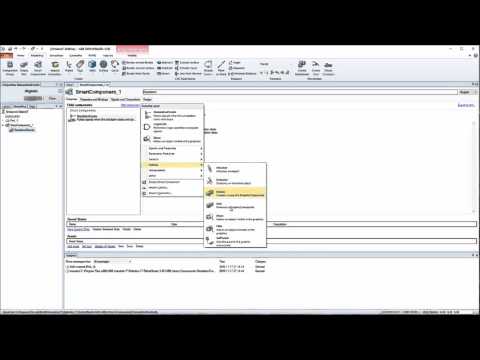

Hello,
I am new to RobotStudio. I am trying to make some parts I created to be visible only at certain times during simulation. Basically, I have a surface, and I want Part 1 to be displayed on the surface at like 3 sec, Part 2 to be visible at like 5 sec, and so on and so forth. I have been reading into the Smart Components a little, but I am thinking maybe this isn't the way to go. Perhaps it is because I am not really sure how to create a smart component. Is there a way to just go into the RAPID code or the part itself and state that I want that particular part to only be visible starting at 3 seconds after the simulation has started? I am working in RobotStudio 6.01.

Smart Components is the way to go and what you want to do is quiet simple. I have posted a short video on youtube on how to do it
https://youtu.be/Zz9o8THBzlU

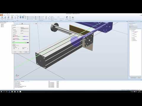

I will try to put something togheter during the weekend, don't have the time until then. If not Johannes W does it before, he get's paid for posting here :-)Per Svensson
Robotics and Vision Specialist
Consat Engineering0 -
Thanks to all!
Here is the first step. Creating the pusher mechanism
https://youtu.be/ViPrRYcDPRU
