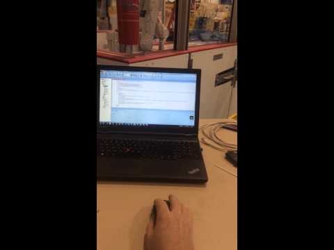

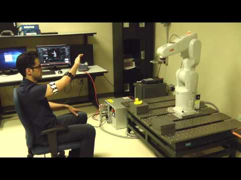

You should probably use EGM option
Videos of EGM based applications or tests.
https://www.youtube.com/watch?v=3bywmHWcgdA
https://www.youtube.com/watch?v=wKiJaK-RDKI
Thank you for replying. Actually, I succeeded to use EGM Pose mode for usual IRB robots and it really worked well. However, YuMi doesn't have a capability to use EGM Pose mode, that's why I still need to use ordinal Move instruction to realize the same thing.0
