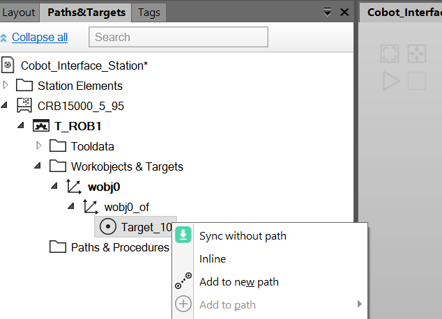

[Request] RAPID Synchronization
Hello Denis,
Thanks for your suggestion.
I'll bring this to R&R's attention.
Thanks!

Great idea. Select/multiselect and then right click to sync.DenisFR said:Hello,Can you add ability to synchronize directly robtarget and jointtarget (PERS or CONST), even if they are not in paths?

Hello Denis,
Unfortunately, R&D decided that this functionality is not something they will spend time on implementing.

Maybe can be done with addin?DenisFR said:If code was open, I can take a look at it.
Systemintegrator - Web / C# / Rapid / Robotstudio
If I helped, please press Vote Up
☑️2024 - RobotStudio® User Group0 -

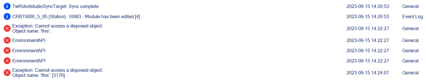

I had some spare time and made a addin that does this.
Target's get synched to the module selected in Settings -> Synchronization -> Targets/Jointtargets
But it's not 100% tested and 2 known bugs are:
* Sometimes when selecting multiple targets only last target gets synchronized.
I have had a few station crashes where a minute after last sync I get these errors:
I have not found out why this happens and don't know when i'll have time to debug it.
But I'll share the source code if anyone want's to look at it
Sourcecode https://github.com/JETomi/TwRobotstudioSyncTarget
Packaged addin : https://github.com/JETomi/TwRobotstudioSyncTarget/releases/tag/addin
