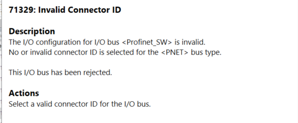

  • Hi,
    I tried this I/O configuration in RS :
    EIO:CFG_1.0:5:0::
    EIO_BUS:
          -Name "Virtual1" -ConnectorID "SIM1"
          -Name "Profinet1" -BusType "PNET" -ConnectorID "PCI1"\
          -CfgPath "pcst_1.xdb"
          -Name "Profinet_SW" -BusType "PNET" -ConnectorID "LAN1"\
          -CfgPath "pcst_1.xdb" -PN_IPAddress "172.16.40.67"\
          -PN_SubnetMask "255.255.0.0" -PN_Gateway "172.16.0.1"\
          -PN_StationName "ae1510-1-erb-45001" -PN_AutoConfig "Group"

     and received these errors :

  • Hi,
    I'm today on site, I've put the last config in the robot, I don't have any issue anymore.
    But the problem is that the DSQC678 board is connected to the LAN.
    When I configure it in this way, it's Nok.
    That means the ConnectorID "LAN"isn't recognized

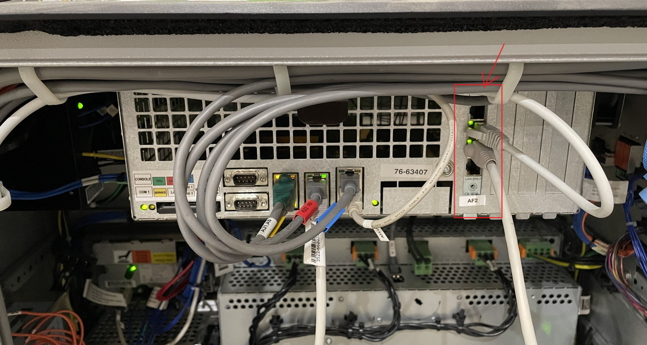

  • That board is not in a PCI expansion slot in the main computer?  I had regedit searching for NetNames+ and Profinet Configurator for hours last Friday, I was trying to find the location of the source from which I installed those.  I was also searching for the install files on some of my removable media, I have not found it yet.  Have you asked anyone about those programs?  Trust me, they can be used, I have used them before, I just cannot find the installer yet.
    Can you post a picture of the inside of the controller with the board?

    The board is on the slot directly on the main board

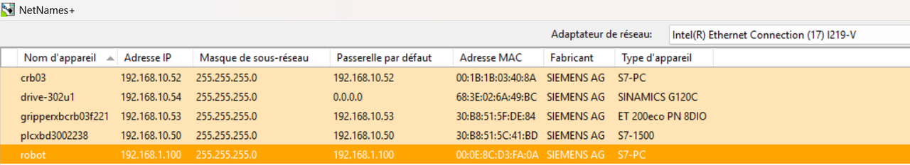

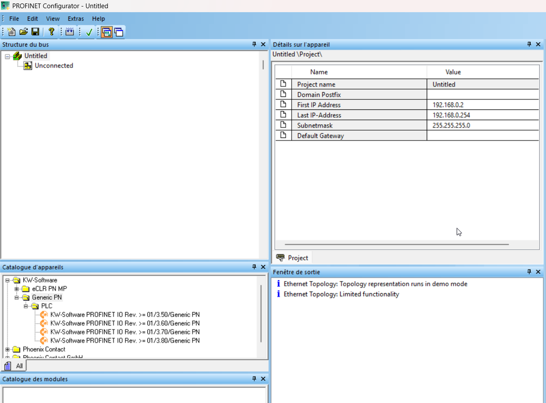

    I found PROFINET Configurator in an old RW installation backup
    PROFINET Configurator seems to allow only Master configuration. My robot needs to be Slave of the PLC.
    In the installation is Net+Names : When I connect to the PN Board, I can see the complete  PN network.

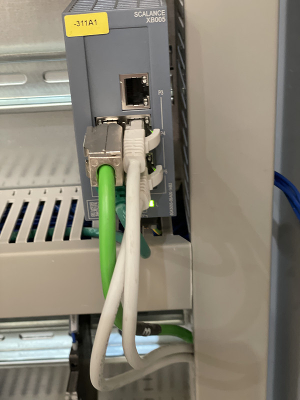

  • I revisited the picture you posted, I had to zoom in a lot.  There are two ethernet cables plugged into that card, where do they go?
    Lee Justice
  • This picture was from some test, there is only one cable to PLC
    Regards
    Cornet Raymond
    Manager
    +352 621 354 570
    raymond.cornet@luxrobotic.com
    http://www.luxrobotic.com
    HP ZBook Fury 16 G11
  • Oh, OK.  Direct to the PLC or is there a switch in between?
